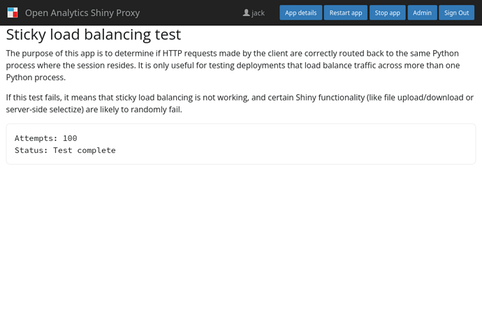

There is also an app that allows you to verify everything is working correctly. I tested this with both the old and new setup, and in both cases it’s working. So probably the old setup was fine as well, but of course it’s better to follow the best practices.
